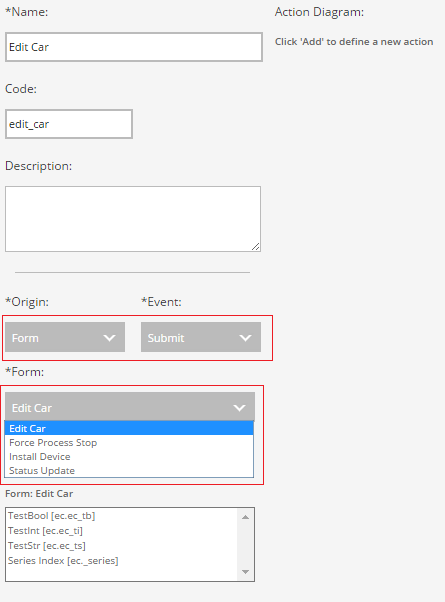

Form - Submit
The system executes a routine with this origin event when a certain form is submitted by any user. When building a routine, the user can select the desired form from among all those defined for the current account. All routines with this type of origin event have at least one context variable, identified by the code of the selected form; this variable stores all the values submitted using the form. In the example shown in the screenshot below, the "Edit Car" form has the code "ec", so the "ec" context variable stores the values entered into each of its fields.
If any of the fields of a form reference other objects, the system exposes those objects to the routine as context variables as well using the code of the Reference field.

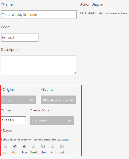

Timer - Weekly Schedule
The Fusion Connect platform can also run routines on a timer. The "Weekly Schedule" option allows the user to select a time of day, time zone, and any of the days of the week; the system will execute the routine on that time on each of the selected days every week. Routines using this type of origin event have no context variables.

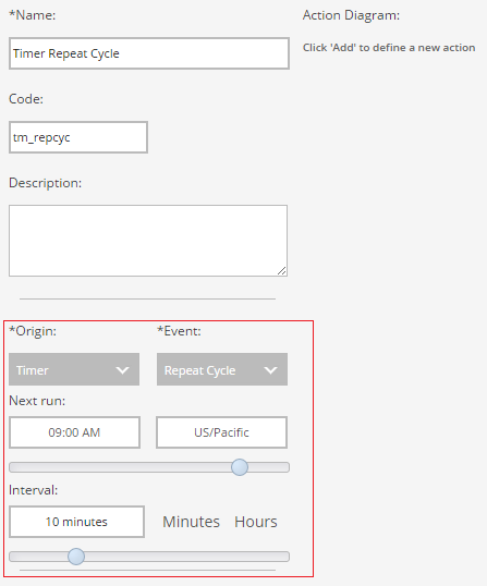

Timer - Repeat Cycle
The system repeats the following cycle: wait a predefined amount of time, then execute the routine. The user can define as an interval any whole number of minutes or hours, with a minimum of 1 minute and a maximum of 24 hours. The user can specify a certain time within the next interval length to execute the routine; in the below example, if the current time is 8:52 AM and the user selects an interval of 10 minutes, he or she can select any minute up to 9:02 AM at which the system will execute the routine. The timer then resets to the full interval length at that point, so the system will run the routine at 9:00, 9:10, 9:20, and so on. As with the Timer - Weekly Schedule origin event type, routines using this trigger have no context variables.
